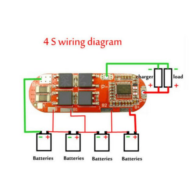

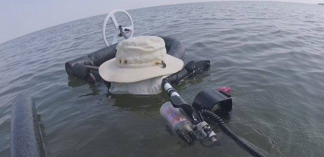

I have made a few batteries for the AQ...if you want the run time the number is 10.5 to 10.7 mAh per minute. So if you have a Samsung 35E 18650 3500 mAh 4 cell battery pack the run time is around 5 Hours and 30 Minutes...It is a Battery Hog...but it's performance is Amazing.
4s2p LG 2600 mAh x 2 = 5200 mAh....8 18650's run time is 8 Hours 10 minutes-----------
4 cell Shorty battery pack Samsung 35E 18650 3500 mAh....run time is 5 Hours and 30 minutes
4 cell MBL 5000 mAh 26650 drop in battery pack....run time is 8 Hours (Sorry corrected)
4s2p Samsung 35E 3500 mAh x 2 = 7000 mAh 8 18650 ....run time is 11 hours..
Dernière modification par OBN le 11 sept. 2020, 18:11, modifié 1 fois.

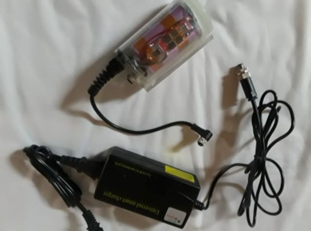

 #1659963  par Edge
Thank you OBN to take time to post some picture of your home made battery pack; really good work :super:
I have a question please, is it a voltage regulator module we can see on your pack or simply a secure voltage card ?
Sorry mate, my english is a little limited :hehe:

Edge a écrit :Thank you OBN to take time to post some picture of your home made battery pack; really good work :super:
Thank You Edge!
Yes they are BMS PCB, Battery Management System,
Protects Lithium battery pack from overcharging, over-discharging and over-draining
then I use a polyfuse...... circuit protector ..4.2 amp
 #1660189  par Edge
Thank You Edge!
Thank you very much OBN :)
